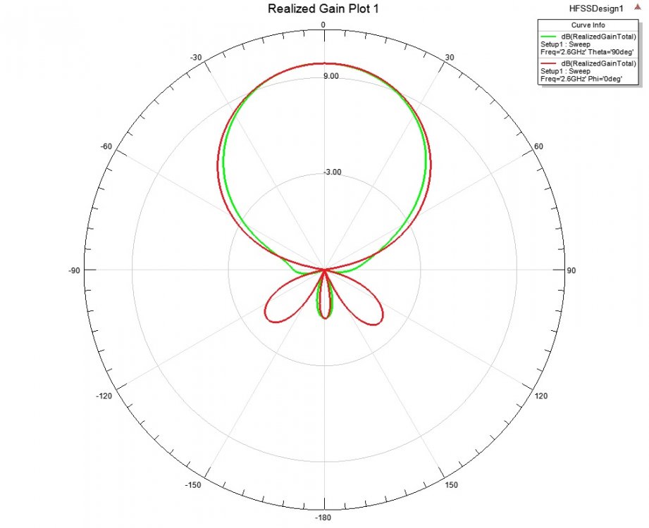

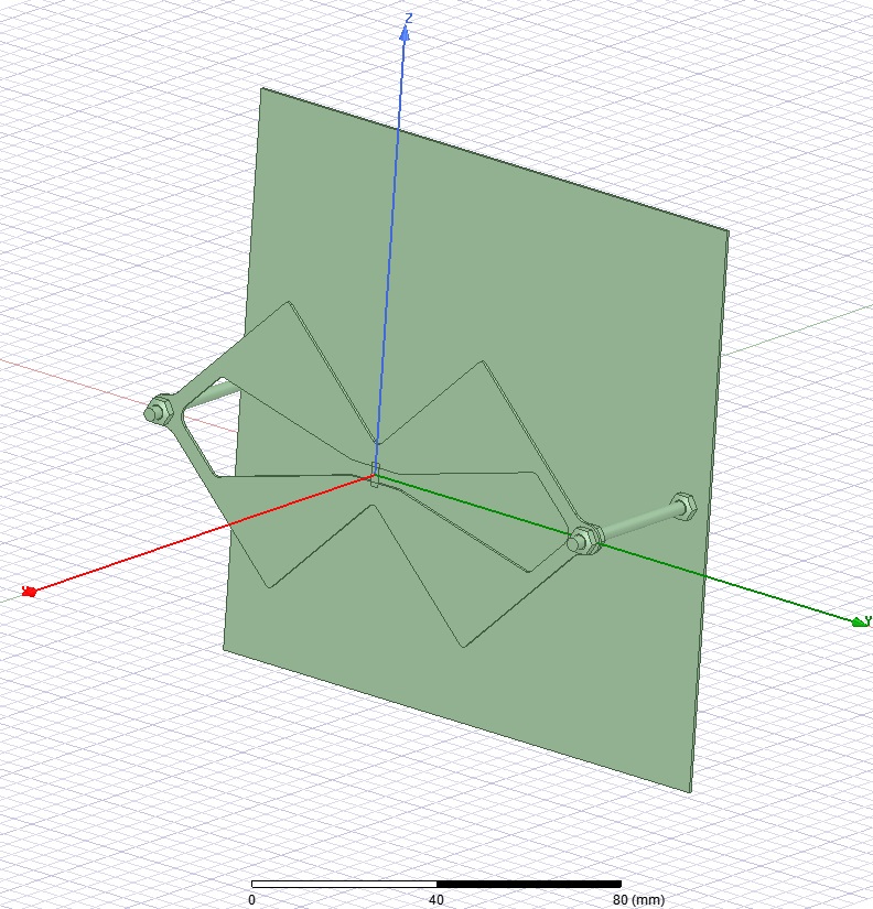

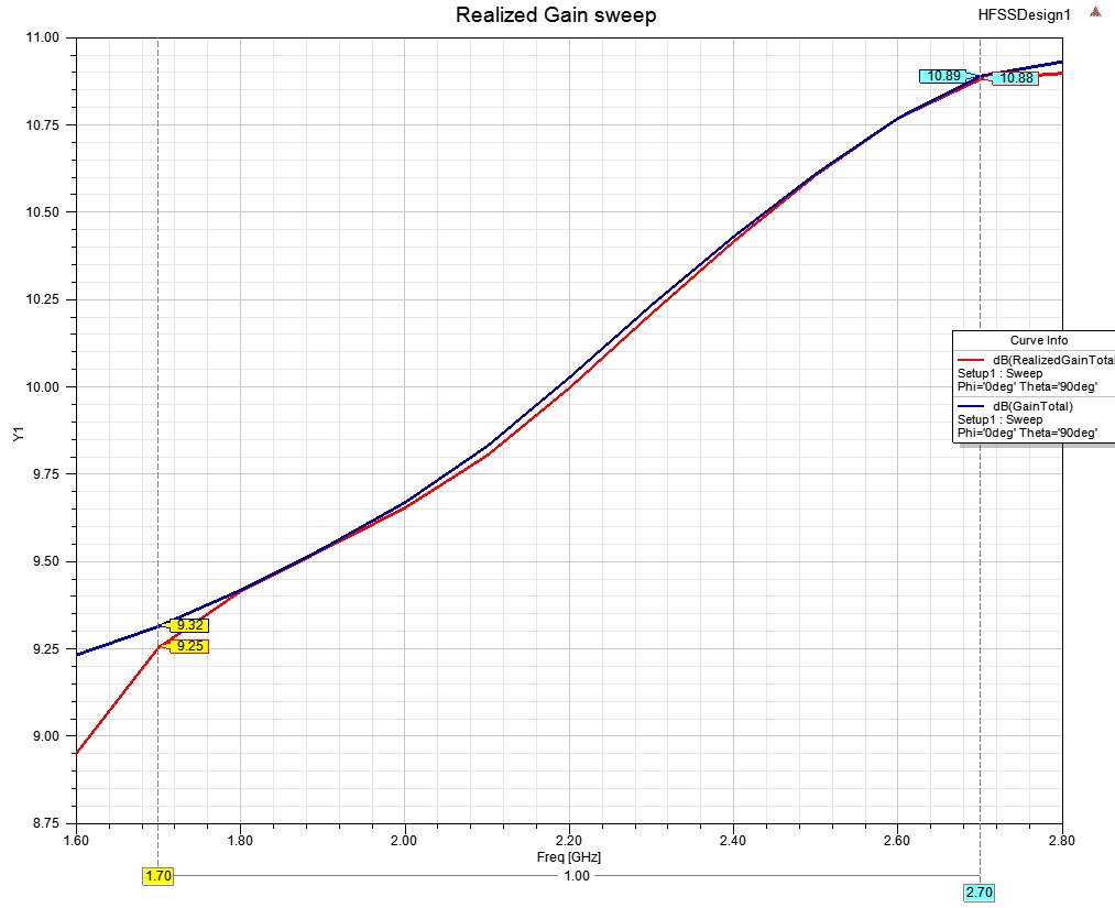

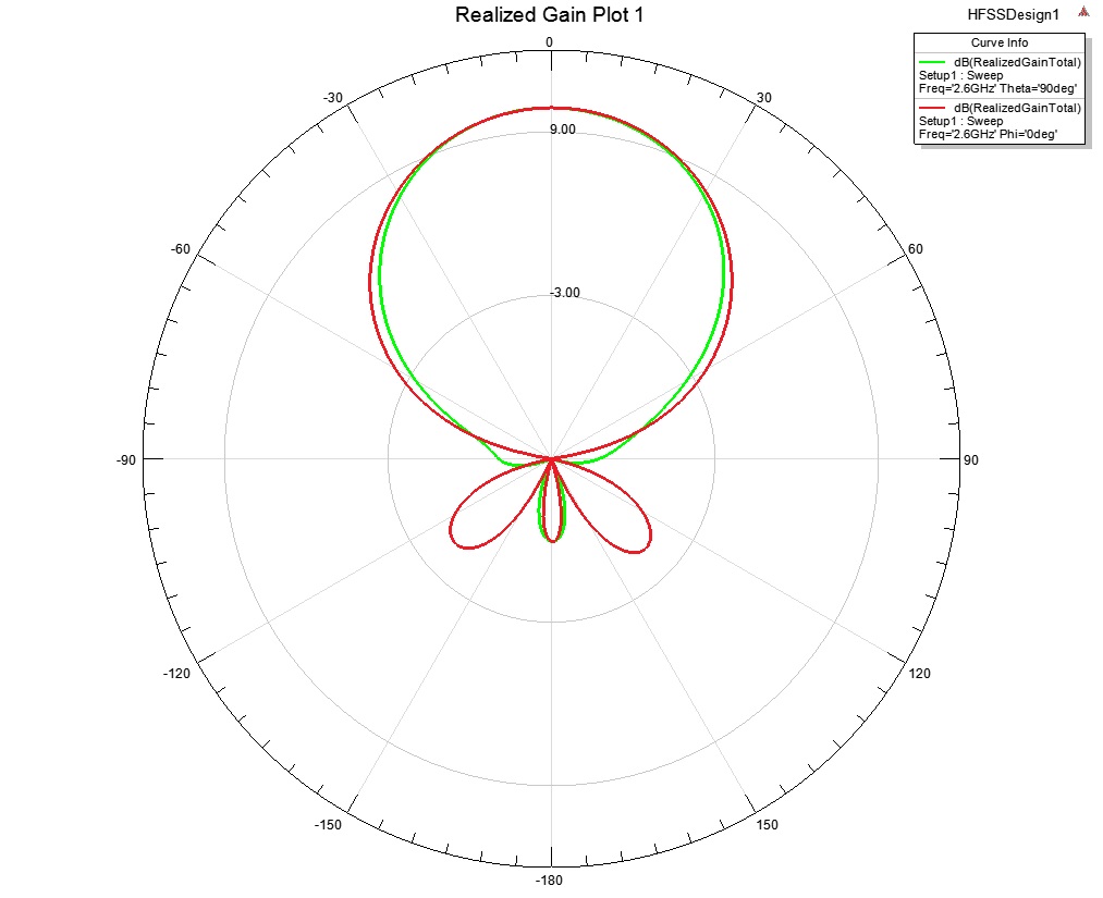

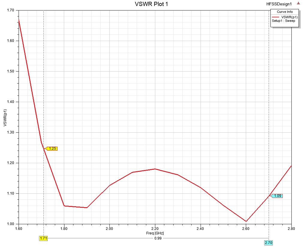

My version 3G/4G antenna "Harchwing".
Frequency range, MHz    1700-2600 MHz
Input impedance, Ohm    75
Reflector size, mm    130x130
Distance to reflector, mm    35
harchwing.zip
Edited by mirkus

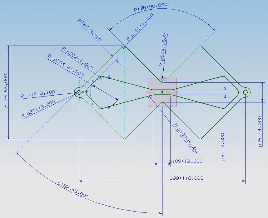

,,,you can also post hfss * file...???  ...or antenna dimensions ...???

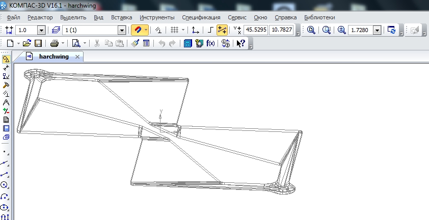

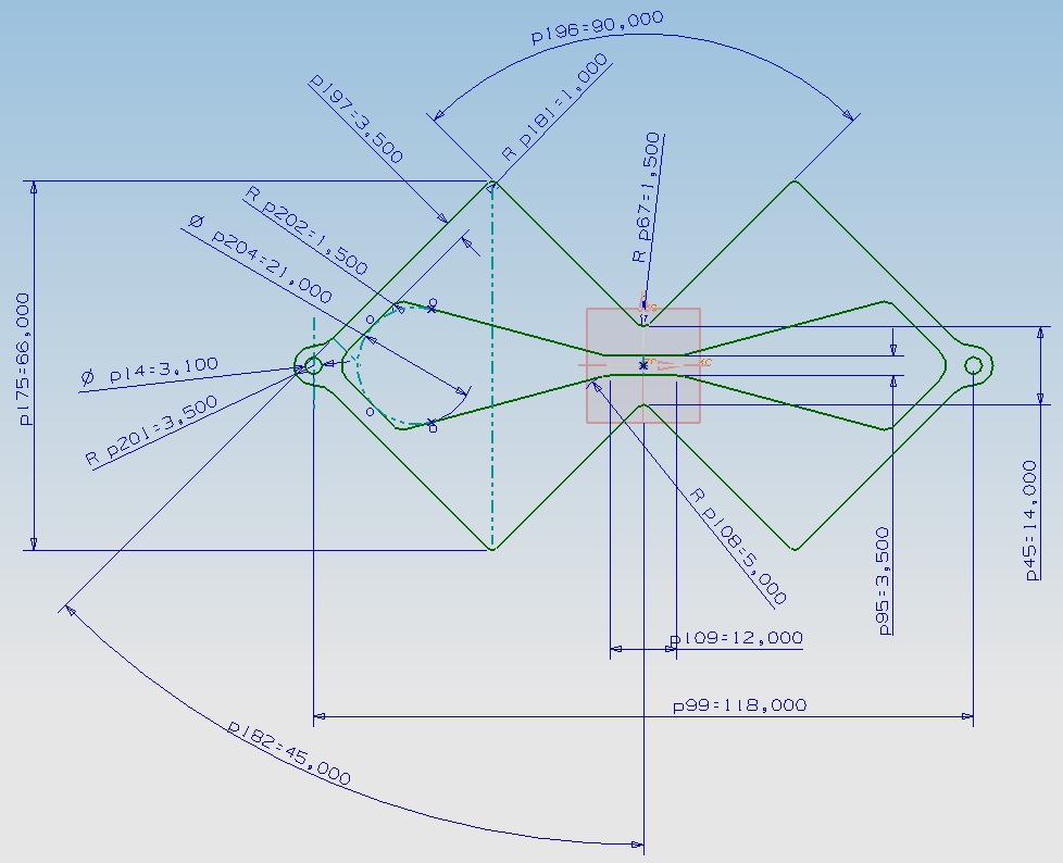

harchwing.zip included "dxf" and "parasolid" file
Edited by mirkus
 I can't open these files...!!!
,,, with KOMPAS this is how it looks...
,,,thanks buddy..!!!
,,, with what program did you make the drawing above...???
Unigraphics NX4

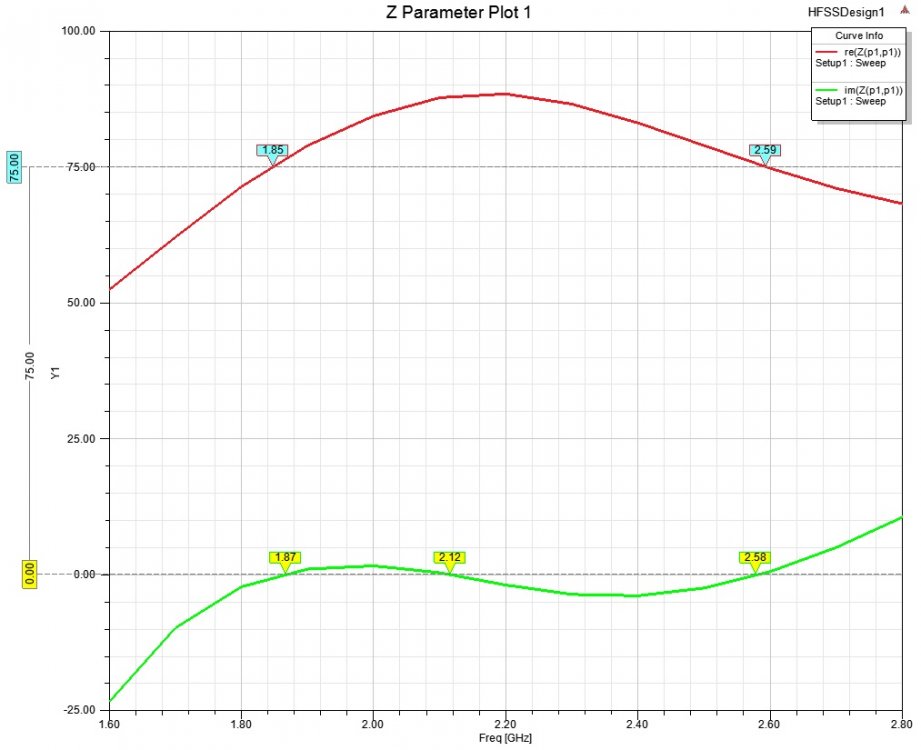

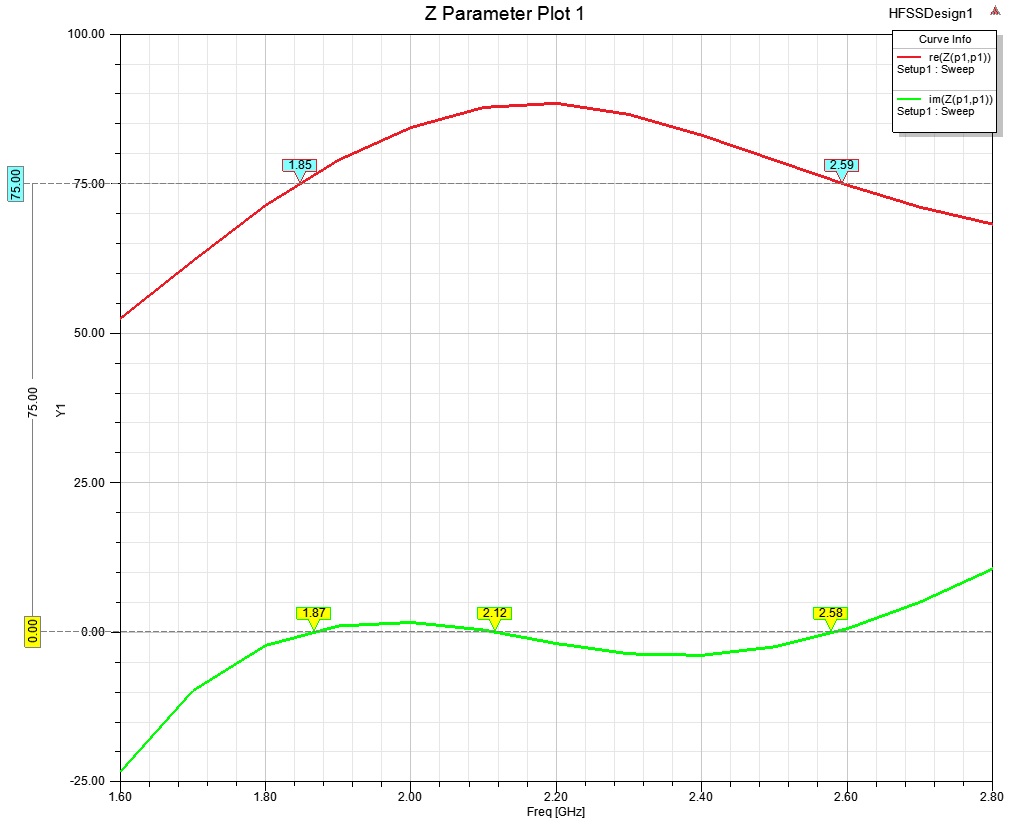

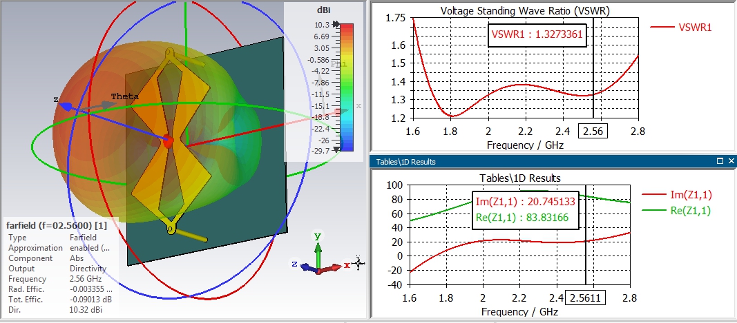

,,yes, it works quite well, the impedance still needs to be adjusted...

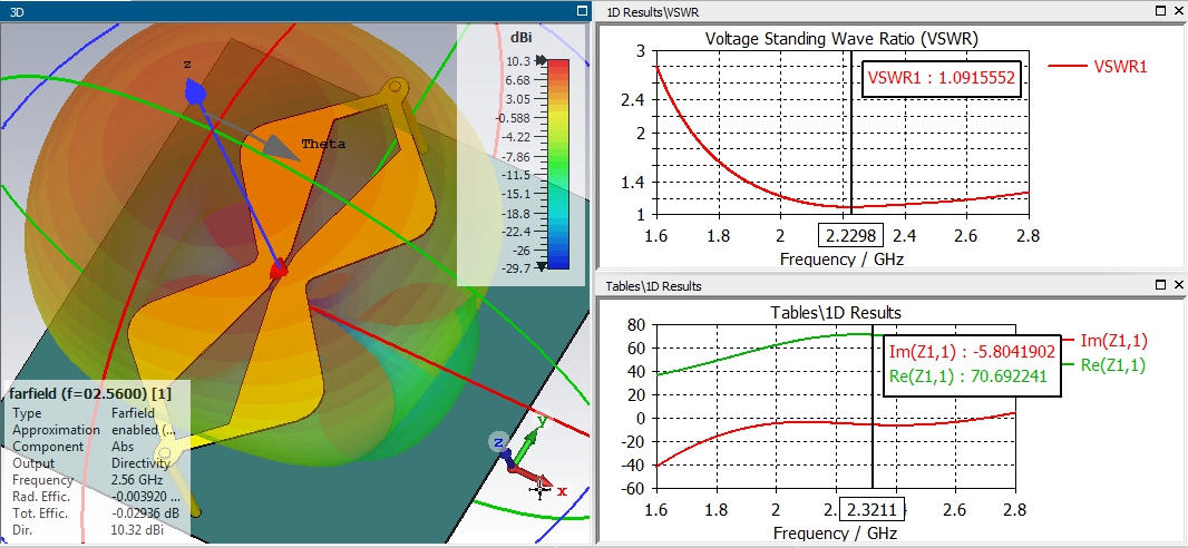

--- after some optimizations----with rounded corners ...!!!
